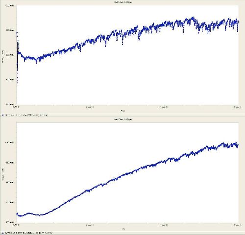

Open circuit potential (OCP) measurements in a naturally-aerated 3.5% NaCl (pH 6.5-7.2) corrosive medium revealed that sealing the Zn-Ni plated steel with the novel trivalent chromium-based coating solution resulted in a positive potential shift from -875 mV (for bare unsealed Zn-Ni-plated steel) to -840 mV (for trivalent chromium-sealed Zn-Ni plated steel) as shown in Fig. 5.
Figure 5 - Open circuit potential (OCP) diagrams for bare Zn-Ni plated 4130 steel (top) and trivalent chromium-sealed Zn-Ni plated 4130 steel (bottom). Sealing with the novel environmentally green trivalent chromium coating solution caused a positive potential shift from -875 mV to -840 mV.
