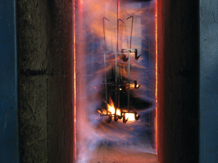

Rack Maintenance Plan
A rack maintenance plan to periodically remove the paint from the racks may be needed to avoid these electrical contact defects. When a variety of part types are run, the electrical contact point is slightly different, and the coating will preferentially coat the former contact points because this is the only conductive point remaining on the rack. With each additional pass, the uncoated area will decrease, and in turn increase the chances of defects. A rack stripping process must be established in plants that observe this problem. Rack stripping can be accomplished by sandblasting; using a chemical removal process (which typically requires circulated chemicals with temperatures ranging from 160–200°F), or by a burn-off process, which requires temperatures ranging from 800–1100°F.
